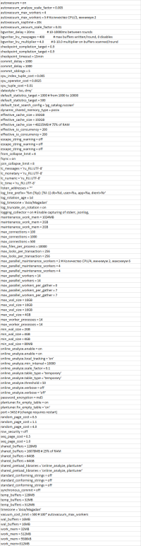

(12)
Подробности
autovacuum = on
autovacuum_analyze_scale_factor = 0.005
autovacuum_max_workers = 4
autovacuum_max_workers = 5 # Количество CPU/2, минимум 2
autovacuum_naptime = 20s
autovacuum_vacuum_scale_factor = 0.01
bgwriter_delay = 20ms                 # 10-10000ms between rounds
bgwriter_lru_maxpages = 400            # max buffers written/round, 0 disables
bgwriter_lru_multiplier = 4.0          # 0-10.0 multiplier on buffers scanned/round
checkpoint_completion_target = 0.9
checkpoint_timeout = 15min
commit_delay = 1000
commit_delay = 1000
commit_siblings = 5
cpu_index_tuple_cost = 0.005
cpu_operator_cost = 0.0025
cpu_tuple_cost = 0.01
datestyle = 'iso, dmy'
default_statistics_target = 1000 # from 1000 to 10000
default_statistics_target = 500
default_text_search_config = 'pg_catalog.russian'
dynamic_shared_memory_type = posix
effective_cache_size = 192GB
effective_cache_size = 48235MB # 75% of RAM
effective_io_concurrency = 200
escape_string_warning = off
from_collapse_limit = 8
fsync = on
join_collapse_limit = 8
lc_messages = 'ru_RU.UTF-8'
lc_monetary = 'ru_RU.UTF-8'
lc_numeric = 'ru_RU.UTF-8'
lc_time = 'ru_RU.UTF-8'
listen_addresses = '*'
log_line_prefix= '%m [%p]: [%l-1] db=%d, user=%u, app=%a, dient=%r'
log_rotation_age = 1d
log_timezone = 'Asia/Magadan'
log_truncate_on_rotation = on
logging_collector = on # Enable capturing of stderr, jsonlog,
maintenance_work_mem = 1024MB
maintenance_work_mem = 2GB
max_connections = 100
max_connections = 1000
max_connections = 500
max_files_per_process = 10000
max_locks_per_transaction = 256
max_parallel_maintenance_workers = 2 # Количество CPU/4, минимум 2, максимум 6
max_parallel_maintenance_workers = 4
max_parallel_workers = 14
max_parallel_workers_per_gather = 0
max_parallel_workers_per_gather = 7
max_wal_size = 16GB
max_wal_size = 16GB
max_wal_size = 16GB
max_wal_size = 4GB
max_worker_processes = 14
min_wal_size = 2GB
min_wal_size = 4GB
min_wal_size = 4GB
min_wal_size = 80MB
online_analyze.enable = on
online_analyze.local_tracking = 'on'
online_analyze.min_interval = 10000
online_analyze.scale_factor = 0.1
online_analyze.table_type = 'temporary'
online_analyze.threshold = 50
online_analyze.verbose = off
online_analyze.verbose = 'off'
password_encryption = md5
plantuner.fix_empty_table = on
plantuner.fix_empty_table = 'on'
port = 5432 # (change requires restart)
random_page_cost = 0.5
random_page_cost = 1.1
random_page_cost = 4.0
row_security = off
seq_page_cost = 0.5
seq_page_cost = 1.0
shared_buffers = 128MB
shared_buffers = 16078MB # 25% of RAM
shared_buffers = 64GB
shared_preload_libraries = 'online_analyze, plantuner'
standard_conforming_strings = off
synchronous_commit = off
temp_buffers = 128MB
temp_buffers = 32MB
temp_buffers = 512MB
vacuum_cost_limit = 500 # 100* autovacuum_max_workers
wal_buffers = 16MB
wal_buffers = 16MB
work_mem = 32MB
work_mem = 512MB
work_mem = 9586kB
work_mem=512MB
Это текущий, но конфиг всяко разно переписывали, результат ваще нулевой ((
